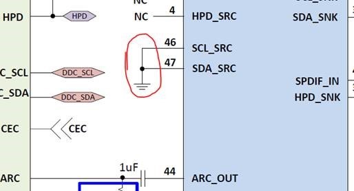

3. Can customer let the two pins of SCL_SRC and SDA_SRC be floating?

    3. The SDA_SRC and SCL_SRC must be grounded. If not grounded, they would interpret system noise on these pins as signaling and hold up the DDC bus trying to send junk data.
