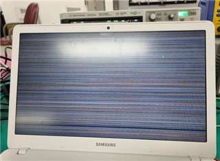

I connected Image module using DS90UB953 + 954 Solution.
But Camera output image abnormal.
I asked Sensor FAE but there is no issue in image sensor register file.
Sensor setting : FHD_60fps_HDR_LFR_PWL12 (12bit)_MIPI1200

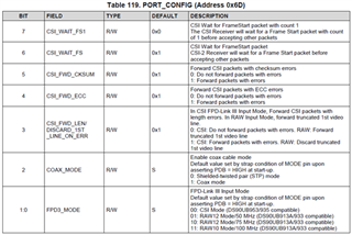

And while I test the 954 register setting, I found some description from 954 datasheet.
BIT1:0 seems to be register for selecting RAW bit. but I think 953 is not supported in RAW12 Bit.
I have questions.
To use 12bit raw image, We need to change Serializer ?
Or could you let me know where I need to test more?
