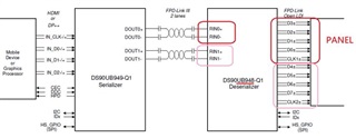

Hello Sir:
If we only use RIN0+/- and D0~D3 + CLK1, is it acceptable?
And if it's acceptable what is the maximum resolution that can be supported?
Please help provide recommendations for us.
Thanks a lot.

Using a single channel is acceptable. When using a single channel, the max pixel clock is 96MHz. Maximum resolution can be found in the following equation:
PCLK = (frames per second)*(total horizontal pixels)*(total vertical pixels)
