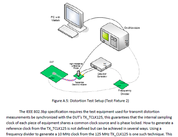

    The clkout signal is connected via a SMA cable with SMA-to-BNC converter to feed to scope channel.
    For distortion test, we are using Tektronix's software signal correction for external ref clock input.
    This is the default option for Tektronix and we have pass results for other DUTs that we have tested previously.
    We will be trying out the hardware clock divider option.

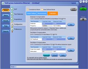

    So perhaps I will share more of the settings of the Tektronix setup.
    Basically I was following to Tektronix 1000BASE-T1 conformance test suite.
    I am using a Tektronix scope MSO64 with the 1000BASE-T1 Automotive Ethernet PMA test suite.
    I attach the document here for your reference.
    TekExpress-Automtoive-Ethernet-100BASE-T1-1000BASE-T1t-OnlineHelp=3=Traditional_US_Letter_PDF=EN-US_077088106.pdf
    The setup you can refer to this picture:
    The DUT is powered by a 7.5V AC adapter connected to the EVM's DC jack.
    DUT ground is also connected to the scope GND port as recommended in the Tektronix document.

    Before the test, calibration steps are carried out as per the Tektronix document:
    The test results is as attached:
    Please help to validate and further advice on possible options that we can further explore.

    Ar you using the 125MHz clock for testing. Please see below and let me know if you have the divider fixture that you could use for testing.
    Sreenivasa

    Sorry for late reply. We tested base don the hardware clock divider and we got pass results.
    So it seems that the Tektronix software option has some discrepancies with the hardware option.
    If your side has any similar feedbacks from other customers, do share with us.
