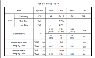

  • Will DSI84 change blanking parameters in the process from MIPI DSI to LVDS?
  • Display D.S blanking parameter is as below, if valid resolution is 1920*1080, what is the blanking? 140, 45 or 280, 45? Why?
  • Hi team,
    DSI84 also pattern generation function, could you kindly tell me the reference register code? Thanks! Customer resolution is 1920*1080, blanking requirement is as above figure. Appreciate for your help!

  • Jiawei
    Please use the DSI Tuner SW to generate the DSI84 register programming value.
    1030.DSI Tuner 2.1.zip
    Please also see this TI training on how to use the DSI Tuner to program the registers base on the display datasheet, https://training.ti.com/configuring-sn65dsi8x-single-channel-dsi-single-link-lvds-operation.
    Can you please share the full display datasheet?
    David
  • Hi David,
    Thanks for your reply! Attached is display datasheet. My customer met display issue like below video when using DSI84, do you have any comments on this issue? Thanks again!
     LCMA-RX0285TB01-C050_147.pdf
