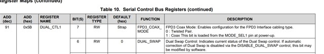

    2. Could we change the Reg0x5C bit7 and 0x5B bit6 to swap the UB949 FPD TX port?

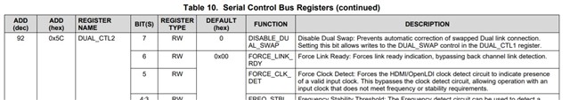

    Have you had any feedback to us? I search for the 949 datasheet and it said that in register 0x5B and 0x5C I suspect if the issue caused by the 0x5C bit[7]=0, so that even if the port wrongly connected, the display will be also normal, what is your suggestion and opinion? Thank you.

    1. In 949 datasheet, I'm confused about the function and description of 0x5C register. In function it said "DISABLE_DUAL_SWAP" while in description it said "Setting this bit allows writes to the DUAL_SWAP control……".
     "Setting this bit" means set the bit from 0 to 1? The default value 0 means disable dual swap or enable dual swap?
    2. In customer previous configuration at 949 side, the 0x5B bit[0] and 0x5C bit[7] set as default values which are both 0;
    Now we have told customer to modify the 0x5B bit[0] and 0x5C bit[7] to 1, while the display also work normally. Therefore, need your confirm by 8/11 that what risk or issue may occur when customer wrongly connect 949 port 0 to 948 port1 and 949 port 1 to 948 port 0, this issue related to that whether customer need to re design the schematic, thank you.

    949 and 947 have the capability to swap the DOUT0 and DOU1 ports as you say. This is a feature listed in the datasheet as DUAL_SWAP.

    So is it possible that:
    Customer previous configuration at 949 side, the 0x5B bit[0] and 0x5C bit[7] set as default values which are both 0——the display is normal, as well as we have told customer to modify the 0x5B bit[0] and 0x5C bit[7] to 1, while the display also work normally?

    I think customer has not tried the 947 since their HU side using 949. So could you please help look into the 949-948 connection and in our 949 register configuration we try 2 sets:
    A. 0x5B bit[0]=0 and 0x5C bit[7]=0
    B. 0x5B bit[0]=1 and 0x5C bit[7]=1
    The display will work normally either. That would confuse both of us and customer.

  • Hi Zirui,
    I would like to inform you that I was able to replicate the issue. When I swapped the hardware or configuring the register doesn't reflect anything. I am still getting lock and display patgen.
    I am currently discussion my team. I will inform you once I have any results.

    I had a discussion with my team. If you swap the ports of the part, it will automatically detect the swap. This is done internally.
    If I manually swap the ports in dual mode, all I am doing is changing the order of even/odd pixel. This is what we expected behavior here.
