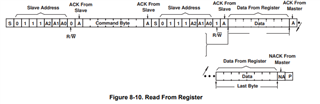

Could you provide some sample code of PCA9554A , our customer find that , the PCA9554A works fine when they write the data(address 70), but it is not work when read the data(address 71) , So they want to confirm whether their code have error .

  • Hi Leon,
    What are the address pins of the device set to? I assume they are are all grounded.
    When you preform a read on this device you have to follow this pattern:
    Notice how the first byte sent is actually a write command (the LSB is 0). So you first send 0x70, then you send the register address you want to access. Then you send a read command (LSB is 1) directly after. So you send a 0x71. This will let the device know that you want to preform a read. After this the I2C device should send it's register contents.
    Let me know if this makes sense and if it worked.
    Chris
