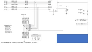

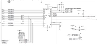

We have two devices from TI on our design, the Ethernet transceiver DP83867IR and TI Hercules TMS570LS3137. The Microchip KSZ9567R Ethernet switch is also used in the design.
The requirement is to have a Ethernet interface between the TI Hercules with the Microchp Ethernet switch KSZ9567R PHY interface.

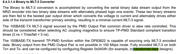

The requirement is how to reach the transformerless design with out the RJ45 jack interface between the TI Hercules and the Ethernet switch device using the DP83867IR.
TI Hercules TMS5703137 MII interface <----> Ethernet PHY TI83867IR <----> No Transformer, No RJ45 jack <----> Microchip KSZ9567R is the desired.
Can you please suggest the feasibility of the above solution? Please suggest the reference design to understand the context much more.

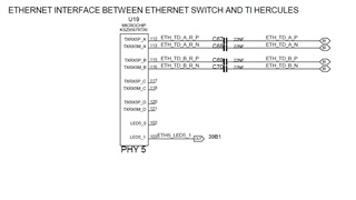

The two pairs of differntial lines are interfaced between the DP83822 and the Ethernet Switch. Please suggest whether the 22nF is enough. Thank you.
