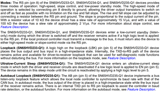

I am going to reference this table below:
This device has three modes that it can operate in, sleep mode, standby mode, and normal mode. If you would like more clarification on how this device enters these modes let me know.
In these different modes the driver and receiver of the device are in different states:
The dominant and recessive current is the current that the device uses in normal mode. All CAN devices when they are transmitting a signal can either transmit a recessive (high) or a dominant (low) signal. For most devices they actually use more current driving the bus dominant. However, for this device it uses the same current when sending a recessive or dominant signal.
