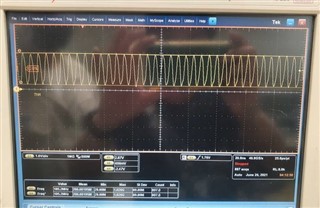

For external CLK using, we understand that we need to input the CLK into REFCLK0.
As I know, compare to UH947-Q1, 941 need single end clk. Do I have any misunderstanding?

Yes, your understanding is correct that is 941AS has a single ended REFCLK, whereas 947 has a differential CLK.
