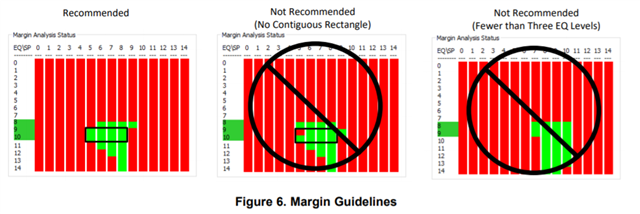

Hi team,
I have question about MAP analysis of ALP, see the below picture, that is in A/N snla301.
why the first one is recommended while the third is not recommended?
as the third picture say the EQ level is fewer than three, but, the first one also less than three? is there mistake?
    "TI recommends having a margin of at least three EQ levels with four passing strobe positions, including a contiguous rectangle of passing states that measures two EQ levels by four strobe positions."
    The first has 3 EQ levels with four passing strobe positions and 2 contiguous EQ levels with 4 strobe positions.
    The second has 3 EQ levels with four passing strobe positions and does not have 2 contiguous EQ levels with 4 strobe positions.
    The third only has 2 EQ levels with four passing strobe positions

  • understood, many thanks.
