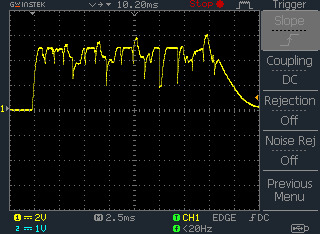

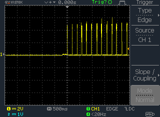

  • I ordered a second TPS65986EVM board which arrived today.  I tested both boards (my original TPS65986EVM and the new one) by connecting them to my laptop.  I connected the USB-B high speed cable to the expansion board and a USB-A to USB-C to the TPS65986EVM board.  Both boards came up with a steady light pattern on the LEDs.  I measured VIN and LDO and they were good (3.3V and 1.8V).  I then put one of the boards into my system connected as I had shown in the previous system diagram.  The TPS65986EVM and expansion board are connected to my SBC via the high speed USB-B cable.  The USB-C connector on the TPS65986EVM is connected to my USB-C board.  The TPS65986EVM board is powered by a 20V laptop supply.  The DP cable is not connected.
    The LEDs on the TPS65986EVM blink on and off rapidly.  I measured the VIN and LDO and they were both good (3.3V and 1.8V).  I must not have had made good contact the last time I measured them.  I then checked VBUS and saw it constantly going to 5V and then back down again.  I'm including screen shots showing VBUS over 500ms, 10ms, and 2.5ms.  I also used the Cypress CY4500 USB-C analyzer to monitor the messages between the TPS65986EVM and my board.  No messages were sent.
    So apparently the TPS65986EVM board is powered up, but it will not provide consistent 5V to my USB-C board.  I don't think this is a PD negotiation issue since I don't see any messages with the analyzer.  I'm not sure what to look at next.  Any suggestions?

    I would recommend programming the TPS65986EVM using the GUI tool from the EVM product page so this way you can configure the PD controller exactly the way the design requires.
    For the VBUS issue, could you check the different boards and make sure there aren't other devices connected to the VBUS of the TPS65986 which could be showing this behavior. I would also recommend scoping both of the CC pins to see how they are behaving.

  • We figured out the voltage issue.  Our USB-C board was programmed to use 5V, 9V, 15V, and 20V.  Apparently that is an issue since the TPS65986EVM is setup to only support 5V and 20V.  We reprogrammed our USB-C board to support only 5V and 20V and we were able to get the voltage to stabilize at 20V.   But then I got to our real problem: the DisplayPort on the TI board isn't working.
