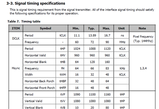

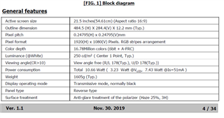

Below is the specs of display that I am using with SN65DSI84ZXHR. I am using 65MHZ crystal. Is that okay to go with or should i go for higher or lower value?

    LVDS Clock = Pixel Clock * (1+%Blanking) = 144 * (1+0.2) = 172.8MHz. For multiply by 3, the oscillator frequency is 57.6MHz.

  • LVDS Clock = Pixel Clock * (1+%Blanking) = 144 * (1+0.2) = 172.8MHz. For multiply by 3, the oscillator frequency is 57.6MHz.
    That's calculated value. can I use external oscillator of 65MHz on REFCLK? What you recommend?
    No, 65MHz multiple by 3 is 195MHz divided by 1.02 = 191MHz, divide by 2 = 95.59MHz, outside the DCLK max frequency range.
    David
  • Hi David, thanks i got your point. Can I choose lower value of frequency than 57.6MHz?
    Any value which lie in the range of DCLK frequency range?
    With minimum of 60MHz, we can work backward, 60*2*1.02/3= minimum 40.8MHz crystal frequency.
    With maximum of 90MHz, 90*2*1.02/3 = maximum 61.2MHz crystal frequency
    So you should choose a crystal frequency within this range.
