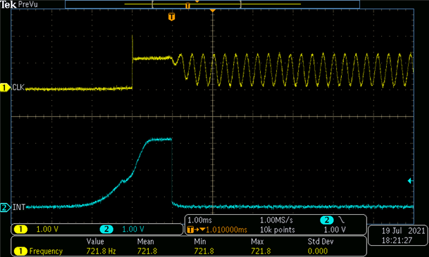

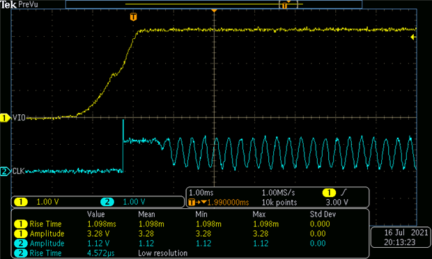

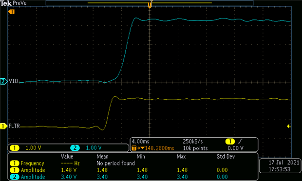

    While checking Power Up Timing sequence in oscilloscope, we observed below
    1. VIO raises after FLTR and Vccout comes up. But in datasheet Figure 15. Power Up Timing, the FLTR and Vccout raises after VIO comes up. Whether this will leads to above issue? Since Vccout and FLTR are the output of the module, why both the voltages are coming before VIO voltage?
    2. Once CLK stabilizes, INT is not going high as provided in Power up Timing, Interrupt pin remains low for the initial 4 minutes. After 4 minutes INT is going high and VCCOUT and CLK is going low. Is this expected ? (We have provided a 10K pull-up for this INT pin)
       Below image shows the behavior of CLK and VIO,
    Whether all these observations are expected?

  • Hi Aysha,
    1. Vccout (and VFLT) are enabled while the device is in standby more. Typically, this is where the INH output would enable the 3.3V regulator so Vio can begin to be supplied. It is expected that Vccout come up soon after the device is powered on initially. Note figure 15 does not show a direct relationship between Vsup and Vio because Vio is supplied by an external source. The delay between Vsup becoming active and when Vccout becomes available is specified.
    2. After initial power-up, the PWRON interrupt flag will be set, causing the nINT output to be asserted (pulled low). This status can only be accessed internally by the device once the clock signal is present. From the scope shots, it looks like the nINT signal does goe high for a short amount of time, but the pull-up resistor is too weak to raise the signal very high before the PWRON reset interrupt is recognized and the signal is driven low by TCAN4550.
    After 4 minutes of inactivity in standby mode (not getting switched to normal mode), TCAN4550 will automatically go to sleep. While asleep, the INH output, Vccout, and clock amplifier are turned off. The nINT line will also go high-z. This is done to leave the device in the lowest-power state in the case that the local node did not start up correctly. To avoid this sleep state, the device must be put into normal mode via SPI write within tINACTIVE of initial startup or wake.

    "Note figure 15 does not show a direct relationship between Vsup and Vio because Vio is supplied by an external source.
    The delay between Vsup becoming active and when Vccout becomes available is specified"
    >> Can you please confirm that this observation of VIO voltage will not create any issue?

    Currently interrupt is going high at the time of clock start up and goes low after 1milli second. Attached capture FYR.
    Looking forward for your reply.
    Aysha T

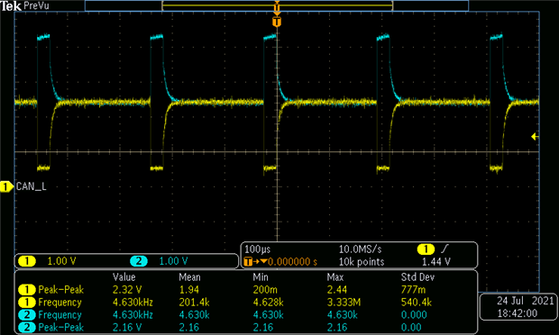

    We have tried below test cases for sending CAN,
    Test case 1: Board to board CAN test
        We are executing below commands,
        In Board-1:
               ip link set can0 up type can bitrate 125000
               candump can0
        In Board-2:
             cansend can0 123#AABBCCDD
    Board-1 didnot print the value sent from Board-2. The CANH and CANL shows continuous data transfer. Attached the image of CANH(blue) and CANL(yellow) FYR.

  • Hi Aysha,
    Were you able to establish good SPI communications with the device? If so, how did you verify this? Are you able to consistently read and write (verified) information to/from the device? If not, please share the SPI captures so I can review the electrical and format data.
    I am not too familiar with the Linux drivers that are not directly related to TCAN4550. If possible, let's keep this discussion high level: register values, desired configurations, electrical observations, etc.
    During test 1, can you read the values of the interrupt registers while the device is transmitting these pulses? It looks like the device is sending error frames, though the pulses seem too short and infrequent for this data rate. I would like to see what the device is reporting. Furthermore, what are the characteristics of the CAN bus during this test? What is the termination value? How long are the cables? Are there any other passive components on the  CAN boards?
    For test case 2, "test mode" significantly changes the behavior of the device by disabling either the transceiver or CAN controller. In the case you describe (CAN Controller test mode), the transceiver is disable and the TXD and RXD functions are mapped to external pins GPO2 and GPIO1 respectively. This allows for the use of an external transceiver with the TCAN4550 CAN controller. During this mode, the CANH and CANL pins of the TCAN4550 are unused.

  • Hi Eric,
    Thanks for the reply.
    Yes we are able to establish SPI communication. We verified with CRO and and also logic analyser. Yes we are able to read/write data to/from the device.
    During test 1, the interrupt value was high. Termination value i s 120ohm.  The cables is less than 1 meter.
