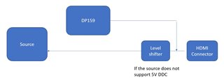

The following is a modified schematic, please help to confirm again!
But there are questions to ask
1.Does source support clock stretching? May need to consider adding the DDC snooping option
Sorry, this is what does this mean?
2,Don't populate external pullup on the OE pin
This is the line follow CRB, OE pin is not on the path reservation SLP_S0 member, using a pull high RC delay OE pin
1. Please see this block diagram for the DDC snooping implementation. SCL_SRC and SDA_SRC must be pulled to ground when implementing the snooping function.
2. The DP159 has an internal pullup, you don't need the external pullup for the RC delay.
