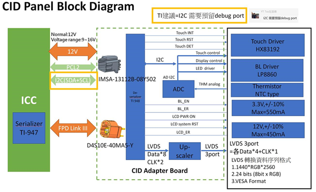

Dear,
Please see attach file for function block and circuit review

Hello YT,
I am reviewing the schematic and will provide feedback by 7/20.

Hello YT,
Please see the feedback attached.SCH_SXC2102-V1_0_20210713A_fbk.pdf
Hi Zoe,
Want double confirm the GPIO0~3 and DGPIO0~3 can not work at same time?
Thanks YT
Hello YT,
In dual link mode, both GPIO and D_GPIO can be used at the same time actually. I'm not sure what Zoe was trying to indicate here but that is ok to do for 948
