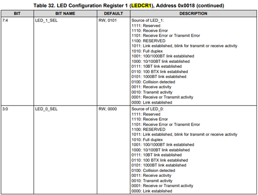

    1. Is the Link light (LED0) controlled by the hardware of the DP83867 or controlled by the software configured?

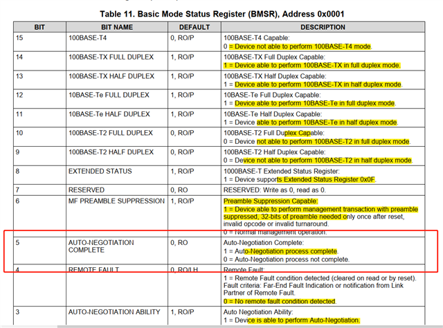

    3. Currently, after the customer has passed some debugging, the link LED turns on after plugging in the network cable, but address 0X0011 bit 11 reads out that Auto-Negotiation has not completed, and the bit 5 of address 0X0001 is correct. May I ask what is the cause of this?
    Software configurable

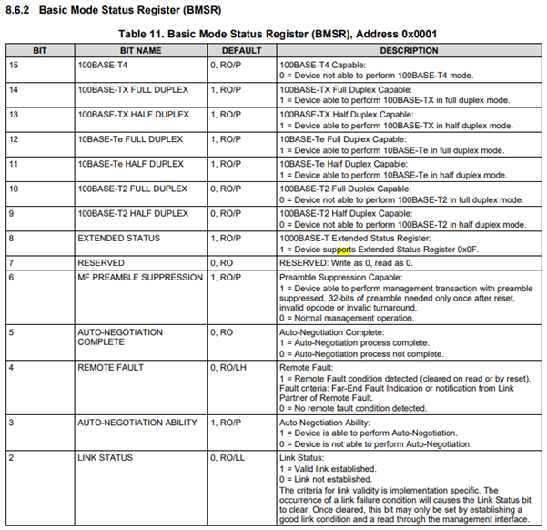

    link is not coming up
    I suggest you take a look at this troubleshooting guide:https://www.ti.com/lit/pdf/snla246
    I also advise you to ensure that your configurations are correct and read register 0x0001.

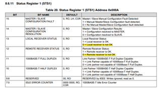

  • hi,we have just done the test according to the  troubleshooting guide documentation,the reslut is:
    the data of address 0x0001 is 0x796d,
    the data of address 0x0004 is 0x0de1,
    the data of address 0x0005 is 0x41e1,
    the data of address 0x000A is 0x0000,
    the data of address 0x0010 is 0x5048,
    the data of address 0x0011 is 0x7f02,
    the status register1(0x000a) is wrong to read 0x0000, others registers is right to our application.please analyze the reasons,thank you!
