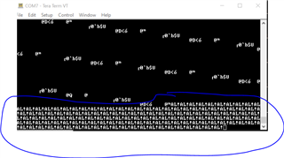

    • I power up, open my COM7 in TeraTerm with 115200 and all the settings outlined in 3.3 (see below for proof COM7 is correct), then do CPU reset but nothing happens on the terminal. It just sits on a black screen even after CPU reset. What am i missing here? Are my boot switch settings wrong? Are my UART settings wrong (i also tried with even parity to no success)? How am i supposed to Connect M4 and load the image mentioned in 3.5.3

I am for sure using the right COM port - confirmed by putting into UART boot mode and receiving AL! on TeraTerm (outlined in this app note for finding the correct com port - https://www.ti.com/lit/an/spracc3/spracc3.pdf?ts=1626270907287&ref_url=https%253A%252F%252Fwww.google.com%252F):

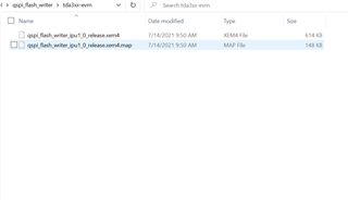

I have generated the proper qspi writer tools:

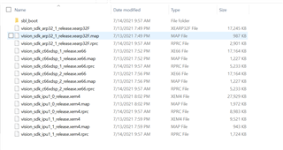

I have generated the proper build files outlined in 3.2.e and sbl appimage outlined in 3.5.2:
