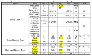

currently we are working on a new design where we integrated SN65DSI84-Q1 and have some issues with I2C configuration of SN65DSI84 adapting to our connected dual lvds panels.
We use a 15.6'' dual lvds panel (resolution 1920 RGB x 1080) with following timing paramters you can see within this message attachements (Panel.jpg). Panel datasheet is also attached!
With the following I2C configuration of SN65DSI84 we get a valid test pattern on tft panel.

Reg=0x3C Value=0x10 (CHA_TEST_PATTERN)  ==> Test pattern mode active!!!
==> Test pattern is OK on panel
==> set Reg=0x3C Value=0x00 (Test pattern mode inactive) only shows a black screen ==> data coming via MIPI-DSI input are not shown on panel
Our missunderstanding between register configuration and example configuration listed on page 34/35 of datasheet (www.ti.com/.../sn65dsi84.pdf
==> Example describes Horizontal active = 1920 or 0x780 but for us it's only working in test pattern mode if it is set to 1920/2=960 (0x3c0)
==> Example describes DSI_CLK_DIVIDER = 0010b – Divide by 6 but value 0010b is not Devider by 6 (reg=0x0b shows DSI_CLK_DIVIDER=00101 – Divide by 6)
Today we have also doublechecked register settings with TI "DSI-Tuner"-Tool and everything seems to be correctly set (see also attached DSI-Tuner input and output pages).
Can you please check what can be wrong in register config for our panel and how you can explain the missunderstanding within the data sheet example?
