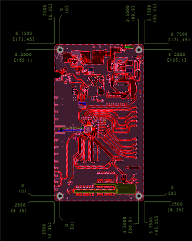

  • Hi Aaron, thanks a lot.
    In addition to the board dimensions I will need the drilling and connector positions, especially J13, J15 and J16

  • Hi Peter,
    Thank you so much for your patience. I was able to find the design file. Below is the information that you are looking for.
    This is the board dimension for 940EVM as well as the dimension for four mounting holes.

  • Hi Aaron,
    Thanks for the dimension's picture. That helped me a lot to place the boad inside my CAD construction. The origin seems to be at the left bottom drilling hole if the PCB is standing on its small edge with the FPD-Link connector showing to the left side.
    But I can't verify the pin1 coordinates for J13, J15 and J16 given in the screenshots. For example the origin of the coordinates 1817,95mil / 1375mil for pin1 of J13 is neither one of the four drillings nor one of the corners.
    Would you check these coordinates again, please? Maybe you have clicked an element inside the PCB where you have started your mesaurements?
    Best regards and thanks for your effort
