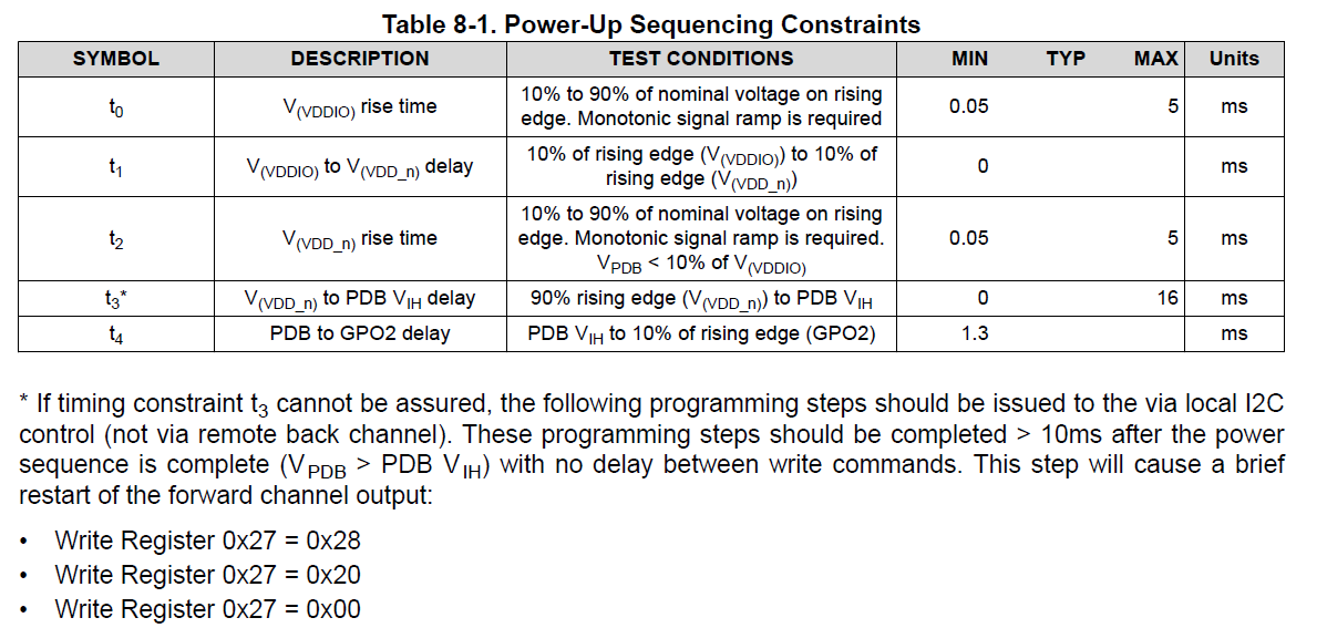

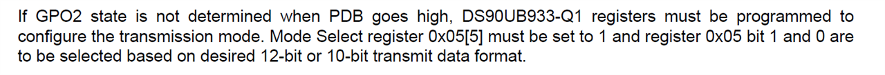

  • Hi Justin,
    I found that my customer floats GPO2 in their schematic, but our new datasheet requires to add a pull down resistor to GND. Now my customer wants to know why GPO2 can't be floating. Could you please tell me the reason?
    In addition, do we have the internal pull down resistor for GPO2 pin? After power on, we test GPO2 is low level.
    Thanks & Best Regards,
    Sherry
  • Hi Sherry,
    We recommend that you include an external pull-down resistor of at least 40-kOhms to the GPO2 pin. The reason is because we have a Power-Up Sequence that needs to be followed in order for our IC to function properly (See Section 8.1.2 Power-Up Requirements and PDB Pin in the UB933 datasheet). The pull-down resistor is needed at GPO2 in order to ensure that the Power-Up Sequence is not violated due to leakage or other external noise influences. The 40-kOhm recommendation was selected in order to not negatively impact the CLKOUT functionality when this pin is an output. And the GPO2 pin does not have an internal pull-down resistor.
    Justin Phan
