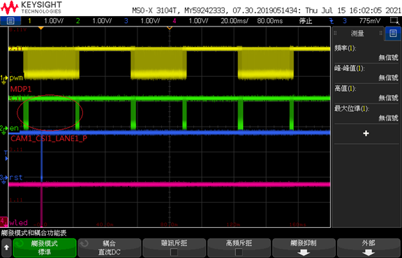

You will see only the head and tail of sensor mipi data converted.
(MDP1 is sensor’s data lane 1 p and CAM1_CSI1_LANE1_P is TI954’s output on data lane 1 p.)
Could you help make sure whether TI954 can not support os02h10_12bit?
Please see the test result of item 3 below:

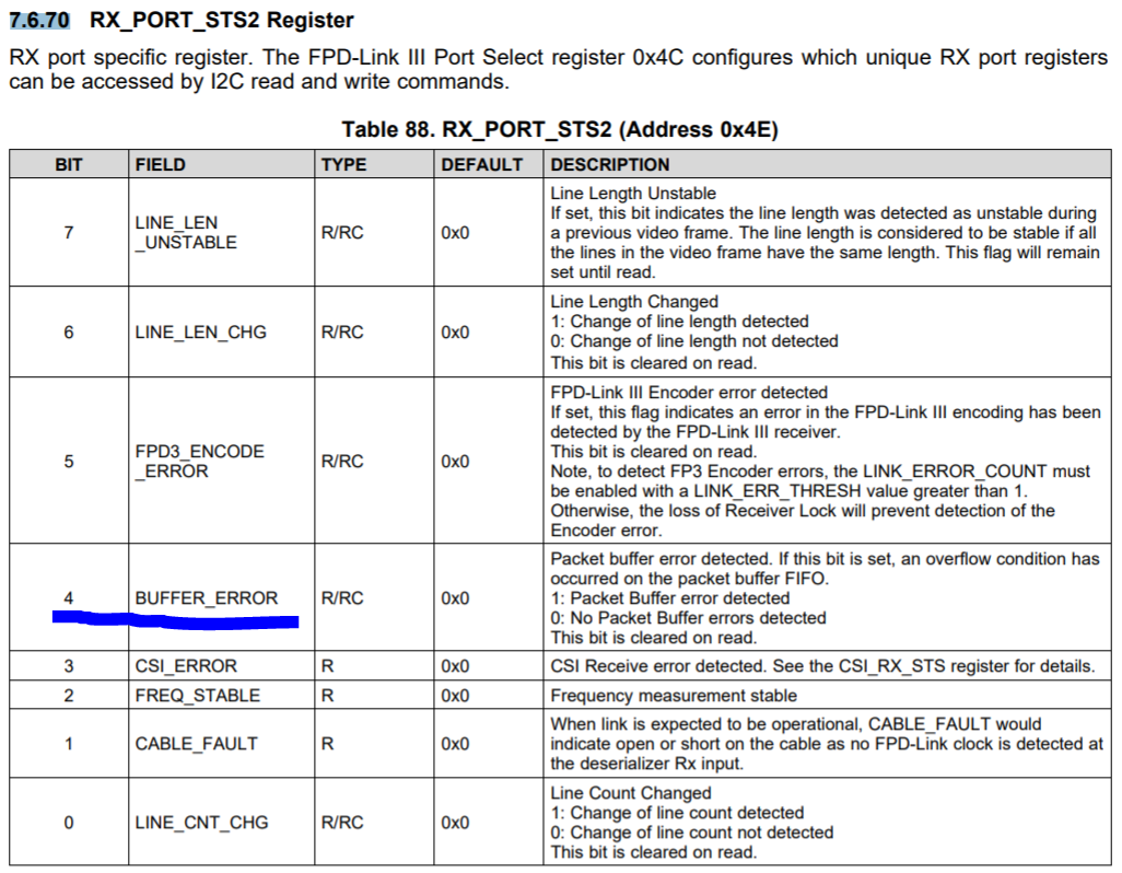

1.ov2718_12bit:(Preview normally.)
01-01 00:01:06.397     0     0 I __show  : 57 0x4e = 0x45
01-01 00:01:08.956     0     0 I __show  : 57 0x4e = 0x4
01-01 00:01:10.862     0     0 I __show  : 57 0x4e = 0x4
01-01 00:01:12.818     0     0 I __show  : 57 0x4e = 0x4
01-01 00:01:14.900     0     0 I __show  : 57 0x4e = 0x4
2.ov2718_10bit:(Preview normally.)
07-17 18:15:17.143     0     0 I __show  : 57 0x4e = 0x45
07-17 18:15:19.676     0     0 I __show  : 57 0x4e = 0x4
07-17 18:15:21.512     0     0 I __show  : 57 0x4e = 0x4
07-17 18:15:23.118     0     0 I __show  : 57 0x4e = 0x4
07-17 18:15:24.503     0     0 I __show  : 57 0x4e = 0x4
3.os02h10_12bit:(No preview.)
01-01 00:02:41.912     0     0 I __show  : 57 0x4e = 0x55
01-01 00:02:43.883     0     0 I __show  : 57 0x4e = 0x15
01-01 00:02:44.787     0     0 I __show  : 57 0x4e = 0x15
01-01 00:02:45.648     0     0 I __show  : 57 0x4e = 0x15
01-01 00:02:46.507     0     0 I __show  : 57 0x4e = 0x15
4.os02h10_10bit:(No preview.)
07-14 08:23:58.082     0     0 I __show  : 57 0x4e = 0x45
07-14 08:23:59.135     0     0 I __show  : 57 0x4e = 0x4
07-14 08:24:00.031     0     0 I __show  : 57 0x4e = 0x4
07-14 08:24:00.857     0     0 I __show  : 57 0x4e = 0x4
07-14 08:24:01.634     0     0 I __show  : 57 0x4e = 0x4

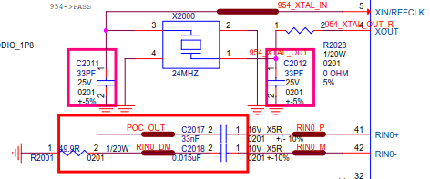

    4.Which Clocking mode are you using on SER and DES?
    Ans: We used ds90ub954 external clock, 24MHz .

    Below are my checks about the mipi clock with different sensors:
    1. os02h10_12bit mipi clock=902.4MHz.
    Ans: No preview.
    2.os02h10_10bit mipi clock=748.8MHz.
    Ans: Could preview normally.
    3.ov2718_12bit mipi clock=768MHz.
    4.ov2718_10bit mipi clock=768MHz.
    Can you help check what the limitation of the mipi clock is in your spec?
    Many thanks
    Denny
  • Hello Denny,
    It is expected that you do not get the correct signal due to the higher CSI PCLK.
    Our UB953 can support a max CSI PCLK = 416MHz, and the UB954 can support a max CSI PCLK = 832MHz.
