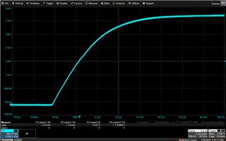

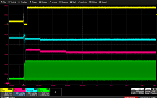

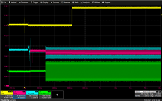

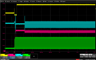

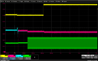

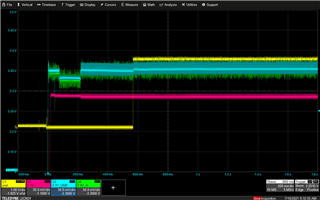

Power supplies could be better but I've seen worse. However, I noted that based on the measurement on the oscilloscope I could determine whether the TUSB was found as a PCIe device:.
  TUSB found
  TUSB not found
When there was little noise on the +3.3V_USB rail (the 3.3V analog supply) the device was found. To determine whether this noise caused the issue or was caused by the issue I connected an external power supply.
With the external supply the noise on the 3.3V_USB supply still appeared in some cases, and when it did not appear the device was found. So it seems it's not caused by the on-board supply.
We noticed that the noise starts approximately at the time the PCIe reference clock becomes active.

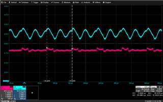

The spectrum analyzer function of our scope shows a peak at 500MHz. Zooming into the trace shows something like an oscillation on the range of 12 or 24kHz:
Do you have any idea what might cause this? And is this likely to be the cause, or is it an effect?

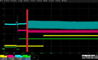

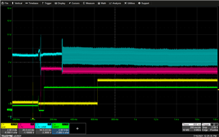

  • Ferdinand, the noise is started at red line below where PCIe clk started?
  • Hello Brian,
    yes, exactly. I just made a measurement showing the PCIe clk as well:
      TUSB not found
     TUSB found
    As you can see the noise starts with the PCIe clock.
    The PCIe clock comes from a clock buffer on a COM Express module and uses a different supply voltage.
    Ferdinand

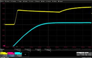

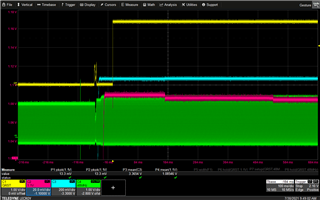

  • Ferdinand:
         can you probe 1.1v and 3.3v, 48Mhz clock and GRST?
    Brian

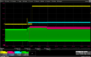

  • Hello Brian,
    sure thing:
      TUSB not found
      TUSB found
    And a closer look at the 48MHz:
    Do you already have an idea what the issue might be?
    Ferdinand

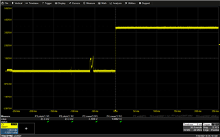

  • Ferdinand:
         I want to see the timing relationship between 1.1v and 3.3v, 48Mhz and Grst. Also need a close look of  GRST, there is a glitch on GRST.
    Can you remove GRST signal and just add 0.1Uf Cap to ground on GRST pin?
    brian

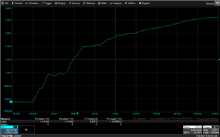

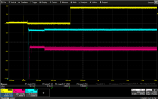

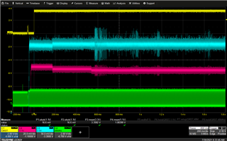

  • Hello Brian,
    here the measurements you asked for:
      TUSB found - additional caps, no ferrite for 3.3V analog and 1.8V oscillator with external supply
    I measured the 3.3V with an active probe and not the voltage rail probe, that's why it shows more noise.
      TUSB not found - additional caps, no ferrite for 3.3V analog and 1.8V oscillator with external supply
      GRST
    The "glitch" always appears and there is no difference visible whether the TUSB was found or not.
     GRST close up
    I added a 100nF cap to the GRST signal:
      Rise-time increased by about 1000x, but it seems to improve things.
    I changed the cap to 1nF wich caused the rise-time to be about 50ns.
    System behavior basically unchanged:
     TUSB found
     TUSB not found.
    I'll try disconnecting the GRST and just adding a cap next.
    Ferdinand
