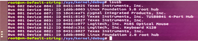

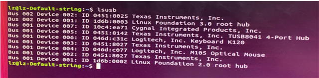

My customer use our TUSB8020B, which device can simultaneously expand USB2.0 and USB3.0 signals.
When customer use TUSB8020B, On one board the two USB ports under a TUSB8020B hub  can only recognize 2.0 devices, but not 3.0 devices, At the same time, their other applications use TUSB8020B are normal can recognize both 2.0 and 3.0 devices.
They replaced the CPU and other devices upstream of this TUSB8020B, and the CPU that has been verified to work normally can still only recognize 2.0 devices after this HUB TUSB8020B.
They scan the USB device in the system, and find
Normal board:
Abnormal board:
At the same time, in the BIOS SETUP, they can also see that the wrong board has a missing hub.
Q1.They can see in the BIOS SETUP that the total number of hubs is greater than the number of hub devices. So in our TUSB8020BIPHPR, are the internal USB3.0 and USB2.0 recognized as two independent HUBs?
Q2.Have we dealt with the loss of only USB 3.0 HUB for this chip before? What are the possible reasons?
Q3.Whether there are related registers to check the working status of the internal USB2.0 and USB3.0 Hub of TUSB8020B?
