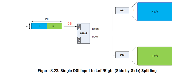

Customer just build up the PCB but one panel no display
They want to know if any setting missing?
Thanks YT
HW Change:
  1. SOC pass video via one DSI PORT, total resolution 3840X720@40 FPS. Each display resolution is 1920X720.
  2. Dout0(L) slave address for 0x2C, Dout1(R) set slave address for 0x2E
  3. Serializer(941) mode set to splitter and 4 lanes
SW Change
  1. Setup LEFT_RIGHT_3D “1”
  2. IMG_LINE_SIZE=0x80, IMG_LINE_SIZE1=0x7
  3. IMG_DELAY Keep default
Result:
Dout0(L) display output normal, Dout1(R) display can’t show anything, and Dout1(R) LOCK LED flash(LOCK FAIL)
    to better debug your system, can you provide me your bring up script and can you provide me with a reg dump of the 948 that is not working? Can you run a BIST test on the port 1 948 to ensure that the link is properly working between the 941 and the 948?

    I get another displays for this dual display experiments. The new experiment summary as below
    Condition
    1. Two pieces display resolution 1280X800
    2. SOC DSI output
    timings.width = 1280*2U;
    timings.height = 800U;
    timings.hFrontPorch = 60*2U;
    timings.hBackPorch = 40*2U;
    timings.hSyncLen = 28*2U;
    timings.vFrontPorch = 8U;
    timings.vBackPorch = 5U;
    timings.vSyncLen = 3U;
    timings.pixelClock = 68935680*2ULL
    1. Ds90ub941 setting

    Result:
    1. Dout0 we can access DeSerializer by kernel driver but display can’t show anything.
    2. Dout1 display LOCK flash issue reduce, the status better than 1920X720 case
    3. Dout1 I2C still can’t access bridge IC slave address
    It seems that your 941As is strapped into the incorrect mode what is the MOSE_SEL0,1 set to on the 941AS?
    Michael W.
  • Hi Michael,
    For MOSE_SEL0,1 shall we use hardware pin set first or we can set by software later?
    Thanks YT
  • You should set them to the correct mode in hardware first.
