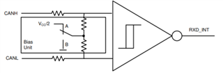

Hi team,
Is the input AMP a fully differential AMP?
My customers are concerned about whether to insert a GND line into the CAN signal line (wire).
Sincerely.

Kengo,
This is the same design as any CAN bus receiver, so it will behave the same as a much more simple transceiver, like the TCAN1042-Q1. Can you elaborate on what you mean by insert a GND line into the CAN signal line? If you mean a ground cable in the CAN bus cable harness, this is a standard practice and there won't be any issues.
