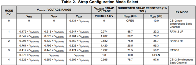

  • Hi Jiawei,
    The UB953 has an internal Always-On-Clock (AON). If you run in Non-Synchronous External Clock mode, the UB953 expects a reference clock at its CLKIN pin. But if no reference clock is detected, then it will use its internal AON clock. In Non-Synchronous Internal Clock mode, the UB953 does not look for an external reference clock and will immediately use the AON clock.
    On the UB954, the strap resistors at the MODE pin decide the mode by setting registers 0x58 and 0x6D at startup. In order to manually set Synchronous or Non-Synchronous mode, you need to select the proper Back Channel frequency and RX input mode. Register 0x58 determines the Back Channel frequency and register 0x6D determines the RX input mode.
    1. For Synchronous mode, you need to select CSI mode in register 0x6D and set the Back Channel frequency to 50Mbps in register 0x58.
    2. For Non-Synchronous mode, you need to also select CSI mode in register 0x6D, but set the Back Channel frequency to 10Mbps in register 0x58.
    See Section 7.4.1 CSI-2 Mode in the datasheet for more information.
