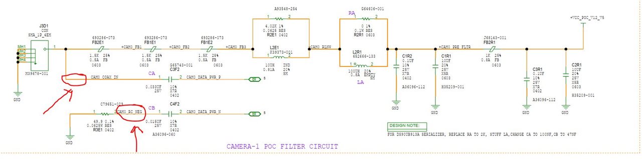

we are working on ds90ub960 camera interface, what impedance to be maintained in highlighted lines? , in datasheet it was mentioned 50OHM, but TI experts saying 100OHM loosely coupled differential pair.
please suggest us the best impedance value?
