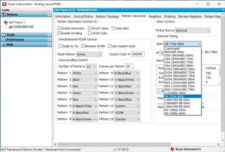

We have one DS90UB941AS-Q1EVM and want to change the resolution to 1280*640.
Can you teach us how to change the resolution to 1280*640?

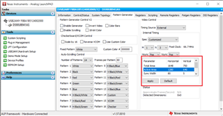

If you want to use the Pattern Generator tab in ALP to change this, you can use the area highlighted below to input custom specifications:
