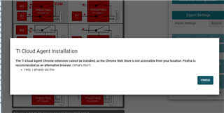

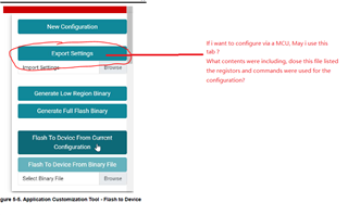

I choose TPS25750 and want to configure as 45W(15V,3A), sink mode, and use a MCU to configure the PD controller via I2Cs.
Right know there are an EVM board(TPS25750EVM) on my hand, and install the firefox brower and TI could agent bridge, but unfortunately, we are fobidding to access the TPS25750 Application Customization Tool.
The configure processdure is did by GUI, how to fast come true the configure in my owen software project?
In order to implement quickly, are there a routine for referance, or ones for similer ICs?
