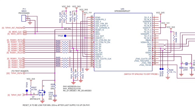

We are using a DP83869 between an AM335x and a 1G SFP.  On the SFP side, the link is coming up. However the SGMII interface to the AM335x is not working.
One thing I notice is that the GEN_STATUS1 register in the DP83869 is 0, indicating "local receiver not okay" and "remote receiver not okay".
First question: What would make them "not okay"?
RGMII_CTRL is 0x00d0, indicating that the transmit and receive clocks are shifted with respect to the data.  I have tried a number of values for DLL_TX_DELAY_CTRL_SL and DLL_RX_DELAY_CTRL_SL in ANA_RGMII_DLL_CTRL.
Second question:  What are the delay values DLL_TX_DELAY_CTRL_SL and DLL_RX_DELAY_CTRL_SL a measurement of (between what and what)?  The description indicates that they affect CLK_90, but CLK_90 does not appear elsewhere in the datasheet.
In case it has an effect:  The 1G SFP wire-side is an RJ45 copper connection going to a switch.  CFG_OPMODE is 1.  Although the switch supports 1G, this link is being negotiated to 100/half.  This causes the AM335x side to set the Tx RGMII clock to 25MHz, while the RX clock from the PHY is at 125 MHz.

  • Hi Vikram.
    Yes, the interface is RGMII.
    I am judging link up using the BMSR register.  It is 0x616d.  Until I added support for 10 base T half and 100 base T full to the Linux driver (drivers/net/phy/dp83869.c), the LINK_STS1 bit in that register wasn't getting set after the renegotiation that Linux performs on the way up.
    Does the entirety of the GEN_STATUS1 register only apply to copper connections?  Is that why the REM_RCVR_STATUS and LOC_RCVR_STATUS_1 bits are not being set in my case, and not an indication of a problem?
    As noted, RGMII_CTRL is 0x00d0 so the clocks are shifted.  That comes about due to my indicating that the phy-mode is rgmii-id in the Linux device tree.  That's what led to my second question about what DLL_TX_DELAY_CTRL_SL and DLL_RX_DELAY_CTRL_SL are a measurement of (between what and what).  I have tried a number of settings for those without success and would like to understand exactly what they specify.

  • Thanks for the info Vikram.  There turned out to be a number of problems.
    First, there's a bug in the Linux driver for the DP83869.  Auto-negotiation results were determined by the generic PHY routine genphy_read_lpa(), but that uses MII_STAT1000 a.k.a. GEN_STATUS1.  However, as you note above GEN_STATUS1 is not valid for fiber connections.  We had to update the driver to use the custom FX_STS and FX_LPABL registers instead.  That allows the cpsw driver to see the link at 1G and therefore set up an RGMII connection for 1G (at 125MHz).
    Second, the problem with 100M connections seems to be in the SFP.  It looks like the ones we have support only 1G connections, not 10M/100M.  With the correct ones and the cpsw driver using 25 MHz for RGMII transmit due to the lower speed link, I'm not sure if there will remain issues on the RGMII bus.  We will see.
    Finally, through experimentation it was determined that the minimum values for delay on the RGMII bus work best in our case.
