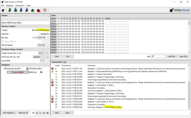

TPS65988: SPI flash selection
Part Number: TPS65988
Due the material shortage, the customer recently change their SPI flash for PD FW.  After using the new part (see datasheet as attached), they failed to load PD FW from it when they use Total Phase tool with error message as below.  Will you help to judge if this SPI flash does not meet the requirement of TPS65988DH or what?
THanks,
Antony
MX25V8035FZUI.pdf
