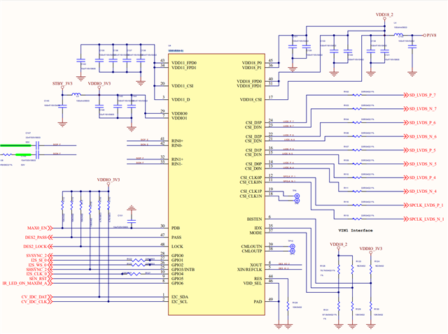

There is currently a project of rear mirror, using 954 + 953 and then 2-channel camera input!
But the problem is when 2-channel input, the screen will freeze within 10 minutes!
1. I would like to ask if there is any debug register for 954 and 953 to verify which section of the problem is (sensor, 953, 954)
2. Please help check DS90UB954-Q1 SCH, THX

  • Hi Kygo,
    Here are some comments on your schematic:
    1. The VDD11_FPD0, VDD11_FPD1, VDD11_CSI, and VDD11_D pins each need their own separate set of decoupling capacitors. Use a separate set of 4.7uF/0.01-0.1uF capacitors at each pin. Do not share capacitors across multiple pins.
    2. For the VDDIO pins, use a set of 1uF/0.1uF/0.01uF/0.01uF decoupling capacitors. The VDDIO pins can share this set of decoupling capacitors. Also, make sure to use a Ferrite Bead with Z = 120-Ohms @ 100MHz. The UB954 EVM uses MuRata BLM18SG121TN1D. Use the same or similar component.
    3. For the PDB pin, use a 33-kOhm pull-up resistor to VDDIO and a 10uF capacitor to GND. You used a 10-kOhm pull-up resistor instead.
    4. Remove the pull-up resistors at the PASS and LOCK pins. These are output pins that output a status.
    5. For GPIO3/INTB, use a 4.7-kOhm pull-up resistor to VDDIO if you would like to use the INTB functionality.
    6. For most applications, TI recommends a 4.7-kΩ pullup resistor to VDDIO at the SCL and SDA pins. But these resistor values can be adjusted based on data rate and capacitive load requirements. See the linked App Note for assistance in calculating new resistor values, if needed: https://www.ti.com/lit/an/slva689/slva689.pdf?ts=1627330437316&ref_url=https%253A%252F%252Fwww.google.com%252F
    7. For VDD18_P0 and VDD18_P1, use a shared set of 10uF/0.1uF/0.1-0.01uF decoupling capacitors. Also, make sure to use a Ferrite Bead with Z = 120-Ohms @ 100MHz to 1.8V.
    8. For VDD18_FPD0 and VDD18_FPD1, use a shared set of 10uF/0.1uF/0.1-0.01uF decoupling capacitors.
    9. For VDD18_CSI, use a set of 10uF/0.1uF/0.1-0.01uF decoupling capacitors.
    10. Add a 0.1uF capacitor to the IDX pin and the MODE pin.
    Justin Phan
