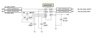

Hi All,
I have a board that uses the MAX3232E chip to drive communication between an on-board micro controller and a host controller that is connected through a cable.

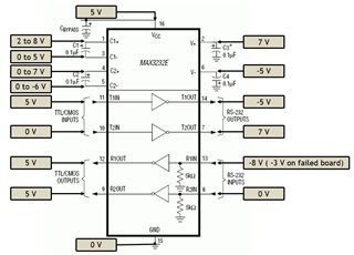

This board has been in production and working well for about 4 years, but over the past year I have started to see failures where the R1IN pin has a low resistance path to ground (about 2 to 200 ohm).
This path to ground seems to be internal to the 3232E chip, as the path goes away if I remove the chip from the board.
About half of the failures occur during a final integration test, and the other half occur in the field within a month or so.
For now I suspect the issue lies with our board manufacturing and/or testing.
Does anyone know what conditions might cause this sort of failure?
REF: schematic around 3232E chip:
REF: Voltage measurements on 3232E chip:

    Is MAX3232E used at both sides of communication? Do you think there could be any change of the RIN input signal? RIN pins work with up to +/-25V. Another place to check is grounding. Although the issue is at RIN, I'm not sure if big ground potential difference could happen to cause the damage.
  • Hi Hao,
    We use a MAX208CDW on the host side communication. I am fairly confident that the RIN input signal has not changed, but a grounding issue does seem plausible since RIN is the only externally driven pin. It could be possible that one of our integration test cables has a grounding issue... Thanks for the suggestion.
