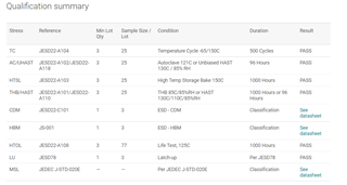

Nikhil,
Looking at Quality, reliability & packaging information of the device, it seems that DP83869HM could pass JESD78. Is this true? Could you confirm this?
If this is true, could you confirm which pins are tested for JESD78?

Sreenivasa,
You can see one DP83869HM passed the latch up test as the attached below. You can see this from the link as below. How should I understand this?
https://www.ti.com/quality-reliability-packaging-download/report?opn=DP83869HMRGZT

Hi Noriyuki,
Thank you for the table. This could be an internal qualification test but not specified in the datasheet as seen in the table you have sent.
Sreenivasa

Hello Noriyuki,
Please see the inputs i have received.
We are testing all pins under LU test.
We are following the JEDEC standard as highlighted in the screen shot you provided ( above) and I would refer the customer to the spec for additional clarification if needed.
