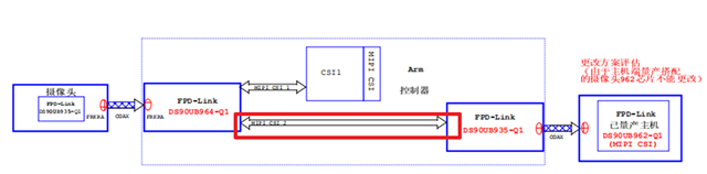

Could 964 output dual same signal? One is for ARM controller, another is directly connected to 935.
In other word, could 964 output connect to 935 input directly? both are mipi, I think it works. Just like to confirm again with you.

Hello Amelie,
yes, this should work. You just need to make sure the 964 CSI output rate per lane is set to 400Mbps not higher. Due to the fact that UB935 can support max CSI throughput = 632Mbps/lane.
