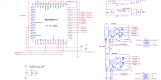

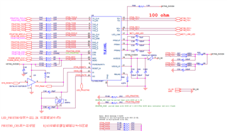

Can the TLK105LRHBT connect to the switch IC? One of our customers wants to use it to achieve switch functionality
As shown in Figure 1: ETH0_TD1+/ ETH0_TD1-, ETH0_RD1_/ ETH0_RD1- direct connection to the transformer and RJ45, and the data link is through. Now connect the ETH0_TD1+/ ETH0_TD1-, ETH0_RD1_/ ETH0_RD1- directly to the port on switch KSZ8795CLX1C, as shown in Figure 2 below:
 Figure 1
 Figure 2
Where the switch functions of the U22 and U30 in the figure are normal. However, after the ETH0_TD1+/ ETH0_TD1-, ETH0_RD1_/ ETH0_RD1- is connected to KSZ8795CLX1C and the U22 or U30 is connected to the PC, the data link is not working, what is the reason? Can we use it like this?
