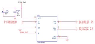

Could you please review the attached schematics designed using TS3USB221. Kindly review and let me know your comments.
Selection input is connected to DSEL pin of charging IC BQ25895M. When S pin is low, D1+ and D1- will be connected to the charging IC. When S pin is high D2+ and D2- will be connected to the processor.
