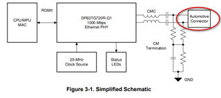

Hi team,
Can the connector in the following figure use RJ45?
Amy
Hi Amy,
Yes RJ45 can be used as the connector, however DP83TG720 is a single pair device so you will need to design accordingly. The RJ45 will also need to be automotive qualified.
