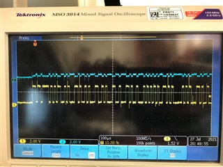

If I start with two new RS485 chips on board1 and board2. I checked the signal on board1 for A and B without board2 connected. Looking at A and B the signals generated
by board1 look good. The waveforms are about 3Vpp and they are what I would expect for a differential signal. This is shown in one of the pictures. I cycled power to
board1 numerous times and signal was fine.

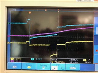

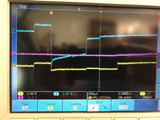

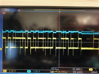

Below are some scope pictures. The first scope picture show A (yellow) and B (blue) as an expected RS485 differential signal. After hot switching one of the boards a number of times I'm seeing the B at 1/4 the amplitude of A as is shown in the second and third pictures. The other two pictures are the sections of the schematic for the design of the circuit involving the SN75HVD10.
    When you hot plugged in board2, I understand not only A/B are connected but also 24V supply and GND, correct? How fast is SN75HVD10 on board2 powered up after connection? Do you observe any spike or noise on 24V rail or A/B bus? Given the abs max of A/B pins is -9V and 14V, I'm not sure if the bus voltage could exceed the limit momentarily.
    Yes 24V and GND are also on the RJ45 along with A and B for the RS485. I have pictures of the power up showing +24V and the 3.3V. I was concerned about this issue also but I did not see a spike or a level below -9V. I saw a spike of about -6V on B and a level of -4V on A. The scope captures on power up were fairly consistent with the pictures. When I observed these conditions on power up the communication was working and I really could not correlate what I saw with the power up process with the abnormal behavior of the transceiver.
    I'm attaching two pictures. In both pictures I'm capturing A (yellow) and B (blue) when I plug in the RJ45 to power up the board. In the first picture the pink is the 3.3V. In the second picture the pink is the +24V. The pattern is somewhat consistent. One difference is the -6V level on the A line. Sometimes I would see that and other times I would not. I really can't explain why that happened sometimes and not other times. I don't think it had any connection to the transceiver failing. The failure mode seems to be on B, not A but sometimes I would see the -6V level on A. Not sure if that is a problem. I still believe all the levels I'm seeing are well within the -9V to +14V acceptable range.

    I did some more testing and I got the same issue on A which was Channel 1 on my scope. I wanted to keep the setup the same to have consistency during my testing but I decided to change it up. I swapped the scope probes and the reduced signal stayed on Channel A. Then I kept swapping the probes and the reduced signal stayed on Channel A. That made no sense at all. I wiggled the connected on Channel A and the scope V/div changed from 2V to 20V. I changed the setting to 2V and now my signals looked the same. The scope was doing a divide by 10 on it's own it was not reporting it on the screen. I removed the probes and re-attached them. I ran 30 hot switches monitoring the startup of Board2 through the initialization and running of Board2 and it worked every time. Even when the voltage appeared to be low on the scope the circuit was working to my surprise but it was the scope that was showing deceptive results.
    I really want to apologize for wasting any of your time. I really had no idea why I was seeing these results. It really helped to switch the probes which pointed out something was not right. The scope is only a few years old and it is a good one but in the future I have to make sure the results on the scope are what I expect to see.
