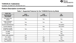

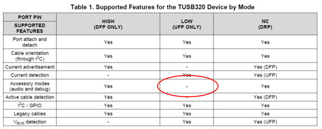

How can a TUSB320 detect an audio accessory in UFP? It looks impossible from the Table 1 in the data sheet. To use audio earphones in UFP, the detection is required in this application.
