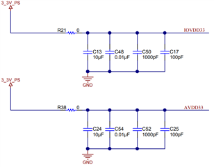

could you please help review the schematics especially for the unused pins.

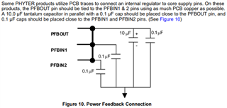

Here is what we found after reviewing your schematic:

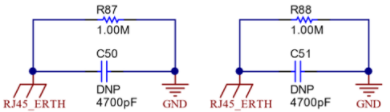

Thanks for your suggestion
1. RJ45 integrates net transformer and the shield will connect to shield GND
Hi Yashun,
You can refer to section 7.2.1.4 of the datasheet for the required specs of the magnetics.
