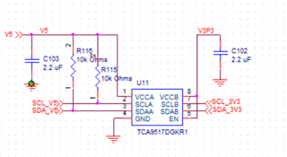

  • First figure shows the set up for the level shifter. On the A side, I have 4 ADCs (ADS1115BQDGSRQ1). The second figure gives you an example how I connected the I2C lines of the A-side with the I2C of the ADCs
  • I don't support these ADC devices so I am not entirely sure how it works. Can you disconnect all the ADC devices from the TCA9517 and check to see if the A side gets pulled up?
    Then you can add in the ADC devices one by one and see which device is pulling the bus lines low.
    Chris

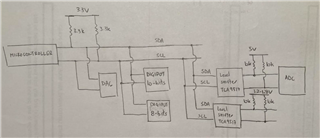

  • Chris,
    Below is a diagram of the PCB I'm currently working with
    The ADC block represents 4 ADCs.

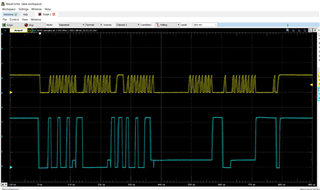

    Now, I have run a couple tests on one of the ADCs. So, the first test I ran I just simply shorted analog input of the ADC to ground. And I get the following on the I2C bus
    The yellow signal is the clock from the A-side of the bottom level shifter (B-side to 3.3 V and A-side to 1.2 V). The blue signal is the data from the 3.3 V bus that the microcontroller is driving. Also, the zero logic level from the microcontroller is not pulled to zero (~0.5 V). Would you have any insight why that happens and what would the remedy be?

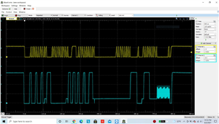

    On the second test, I kept the analog input of the ADC opened; and I get the following
    You can notice an oscillation on the data line and I'm seeing that quite often. Prior to this current board, I was working with another PCB that had only one level shifter (B-side pulled to 3.3 V and A-side pulled to 1.8 V), and I was not seeing that problem. On the current board, however, I have two level shifters (the new addition has B-side pulled to 3.3 V and A-side pulled to 5 V) and this oscillating problem started occurring on both SDA and SCL lines. Would you have any idea what could be causing this oscillation and how to fix it?
  • Hi Alex,
    For your two TCA9517's in parallel are they connected B-side to B-side? It looks like it from my point of view. This is not allowed on this device since it comes with a static voltage offset on the B-side of the device. You cannot connect two static voltage offset devices in parallel together. You will have to flip one of the devices and since there is so supply requirements with this device you should have no issues.
    My next concern is the bus capacitance of all those devices connected in parallel on the B-side of the device. Do you know what your bus capacitance is and have you done the required pull up resistor calculations?
    Chris
  • Yes, currently both TCA9517's have their B-side connected in parallel. So they might be the cause of the problem I'm having. Now, when I flip the devices, the A-side one will be in parallel with the B-side of the other. Would that be OK?
  • Yes that is the correct setup for this device. Let me know if that solves your issue.
    Chris
