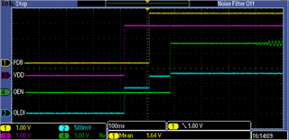

dear,expert:
accodrding to 928 datasheet ,when VDD33 and VDDIO power up,pdb and oen power up,oldi(TxOUT(3:0),TxCLKOUT) output from 0V to normally,but in fact test ,when VDD33 and VDDIO power up ,the PDB and OEN not power up, this time test the OLDI output above 1V DC level, when PDB power up,the OLDI output 1.2V DC level;
1.so I want to know whether this phenomenon is normal;
2.Can I set the OLDI output to 0V by set the registers ?

  • hello Aaron:
    Thank you for reply.this happen on multiple boards, we connect the video source serializer is 981 ,and connect other video source which serializer is 948 , have same phenomenon.
  • Hello Zongtao,
    Is the 928 output connected to the panel? If so are you sure that the OLDI is not getting pulled up by the panel side? Can you check by disconnecting the 928 from the panel? Because our understanding is that before PDB = H, the OLDI outputs should be High-Z
    Casey
  • hello Casey:
    thank you for reply; at my testing,928 output disconnect to the display; so  can you test at you side if it is convenient for you?
    our other diaplay project  which use 948 also have the same phenomenon,they close the OLDI output by set the register;

  • thank you for support ~from my side,I`m not connect to display,but still occur .
