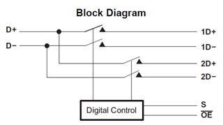

I'm Johnson, I'd like to know that if Port 1D+/1D- connects to USB1.1 device,
Is necessary to connect resistance (28~44 ohms) for each driver output at the Full speed?

you don't need any additional resistance for Mux.

Does TS3USB221 can detect singal of USB1.1 or USB2.0?

TS3USB221 can not detect US1.1 or USB2.0 signal, it just pass though USB signal.

It's fine if 33 ohm resistors are required for USB FS.
