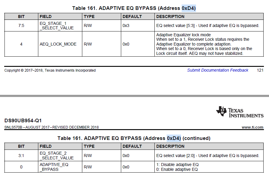

My customer do the ESD test, and they feedbacks that the video display is not smooth, there will be a phenomenon of lag when doing ESD test. We try to improve this phenomenon by changing registers,
1. Change the VOD amplitude. Do we have any registers for VOD configuration?
2. Change the deserliazer's AEQ setting. We try to disable adaptive EQ, and increase EQ value. But I don't know how to change the EQ value? Why do we have two settings,  bit 7:5 and bit 2:0? What is the relationship between bit 7:5 and bit 2:0?
