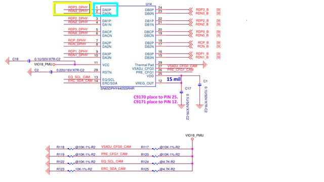

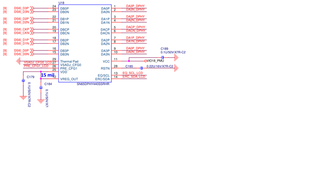

1.Could you help check the SN65DPHY440SS schematic as below and any need to adjust ?
2.In addition 1/2 PIN (lane0) input can be changed to other lane3

Is this a MIPI DSI or CSI-2 design?
David
For MIPI DSI, one of the four lanes is used for back channel communications between GPU and DSI panel. DPHY440’s lane 0 is the only lane that supports the back channel. For this reason, DPHY440 lane 0 must always be connected to lane 0 of GPU and panel.
For MIPI CSI-2, because lane 0 is special lane, I will use lane 1, 2, or 3, and not use lane 0.
