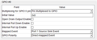

    I requested to connect with you on e2e. I was able to test this and I was seeing the GPIO behaving as expected, I used one of the LED indicators on the EVM to confirm. I have the GPIO configured as below:

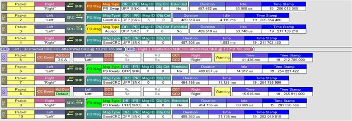

    Here is the PD log I took during the PR Swaps back and forth:
    I wonder if there is something else happening here, do you have the ability to take a PD log to make sure that the PR Swap is successful?

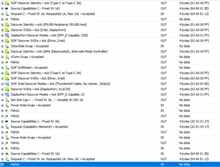

    Here is a snippet of this bad case:

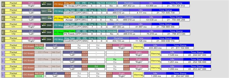

    Here is a snippet of a Success case where I manually apply VBUS on HV2 instead of waiting for "Port 1 Source Sink Event" to occur to drive out the GPIO that turns on VBUS on HV2.
