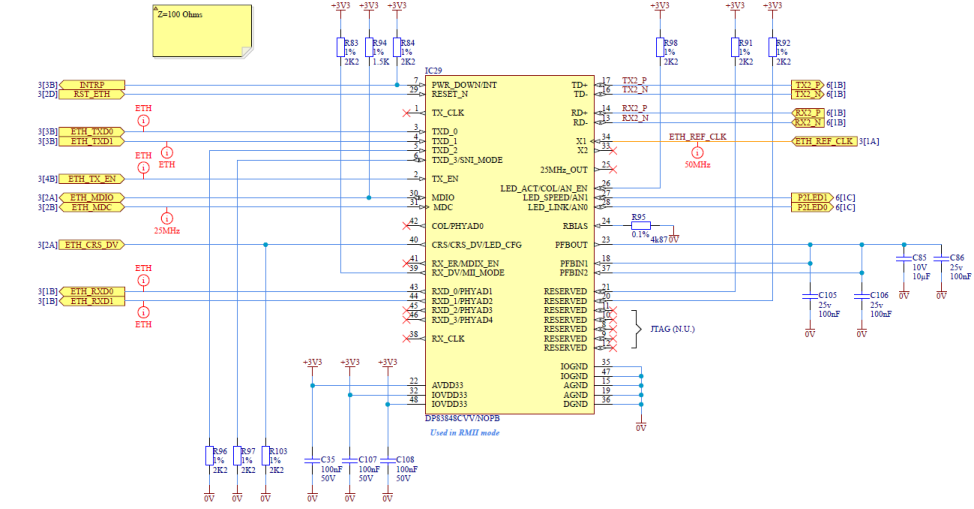

We are using DP83848 PHY in RMII mode with STM32F407 (LwIP stack). The 50MHz ref CLK is generated using STM32 PLL.

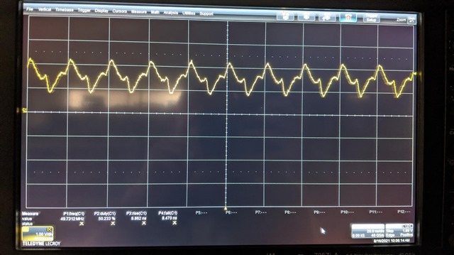

It seems to be a HW problem, so we tried adding 100 ohms series resistors on the X1, RXD0, and RXD1 signals. This made the problem a lot worse. Only a tiny fraction of the frames was transmitted without corruption. Load factor also seems to influence the phenomenon. When reducing the load factor tenfold, the percentage of corrupted frames was reduced.
Here is the CLK signal, without the series resistor

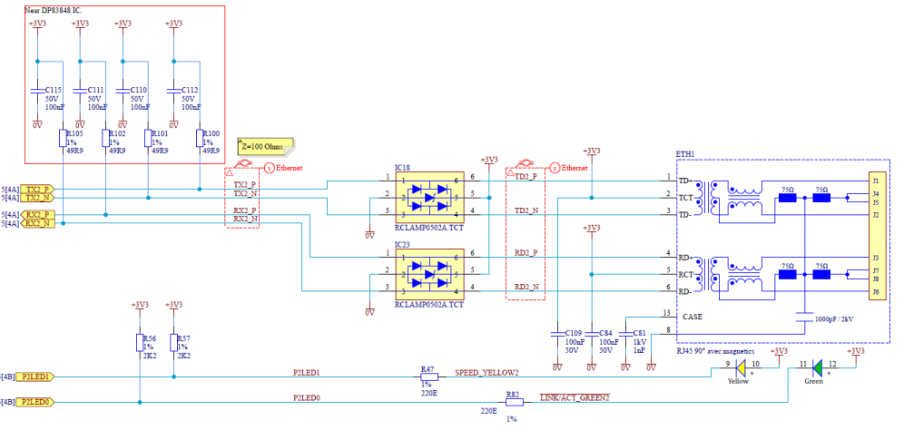

Here are the schematics. I should add that RMII signal traces are quite shorts, as the component is only 3cm away from the MAC. Diff signal traces are a bit longer (10cm). All RMII signals go directly to the microcontroller.
