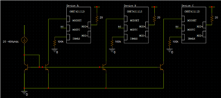

Dear team,
We use several ONED4211LD devices in parallel.
All MODSET pins are driven with the same current mirror.

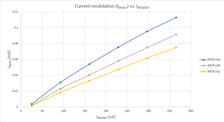

When measuring the modulation current on output MOD+, the output characteristics measured show significant dispersion between devices when changing the current on the MODSET pins (as shown in chart below).
Is this something that you would expect ?
